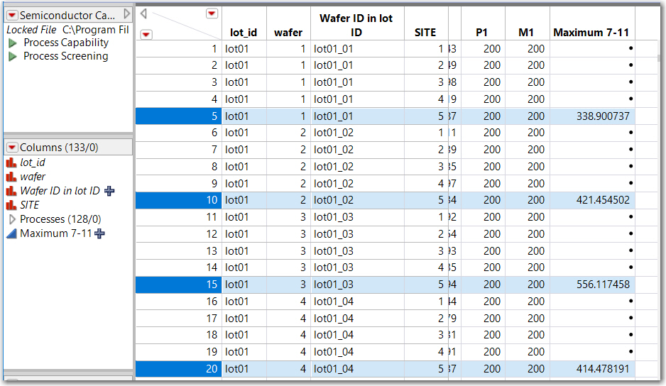

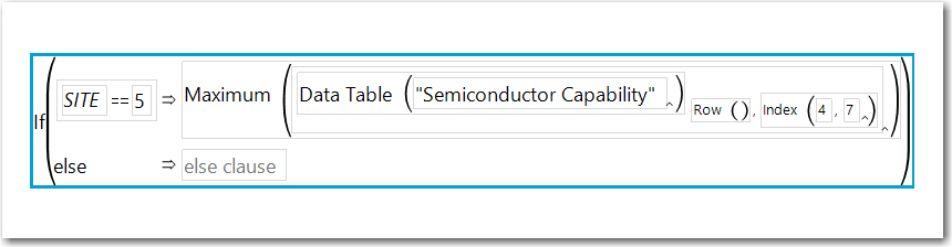

This is not to lessen the value of your request, however, when scripting there is a pretty easy solution since JMP 13. This can also be specified using the formula editor, but it is a little more cumbersome. See the script, the formula and the result below. I don't store formulas in data table unless they are necessary.  The formula editor warns against using Current Data Table() in a formula, so the formula needs the table name. Using my preferred Set Each Value() instead of a formula, the table reference (dt or name in you script) can be used instead of the data table name.
Names Default to Here(1);
dt = Open("$Sample_Data/Semiconductor Capability.jmp");
testcol = dt << New Column("Maximum 7-11", numeric, continuous,
	Formula(If(:SITE==5, Maximum(Data Table("Semiconductor Capability")[row(),4::7]) ))
