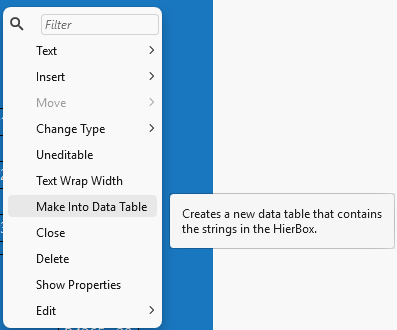

- create a graph on a workbench:
  is already available. Just create a Hier Box and edit it via drag & drop / rename / copy & paste
- build a data table from the graph:
a light version of this idea is already available via right click menu/Make into data table
I agree - much better:
a data table in the background, UPDATED on the fly:
new entries are added, existing entries can be updated by editing the graph.
