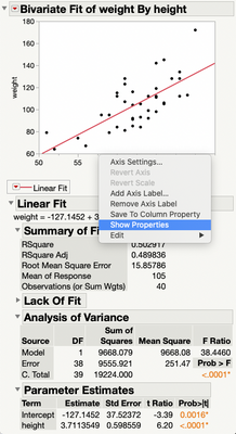

Within Graph Builder and axis settings, while having a nested x axis, the "Tick Mark Style" can be selected to various types, but the weight of the tick mark line can not be increased.  If your boss is like mine, they want this line thickness increased for when the image is shrunk down, so as to remain visible, most notibly when using the 'interval tray' tick mark style.

In JMP 16 the Properties editor for axes has options for line color and width.
