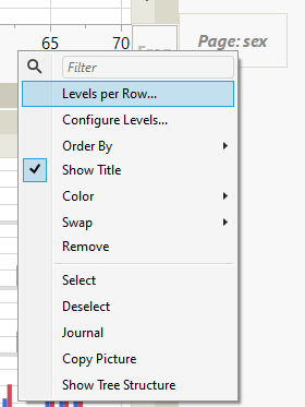

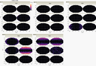

Or even better:
a levels option like it is available for wrap - to define how many pages are placed next to each other
to place pages in a grid next and below each other :)
here: levels =3:

OrderedMapsGnu8
Level I
@hogi Hello. How did you get this option ? I can't seem to find it. I only have the other options except "levels per row"
Thank you in advance
hogi
Level XIII
ah, sorry, it will come with Jmp18 - in a few days ...

Maybe an addon-Wish:
An option Level in View and arrows to show different pages.
(like the functionality available for Group X and Wrap)
hogi
Level XIII
@Sarah-Sylvestre , thanks for delivering this functionality in JMP18
