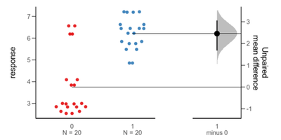

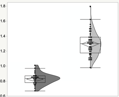

I would add box plots and a half violin plot on the dot plot to the Gardener-Altman plot (as shown in the photo), in this way the information that would be obtained would be optimal.

Box Blot and Half-Violin plotBox Blot and Half-Violin plot
Gardner-Altman PlotGardner-Altman Plot

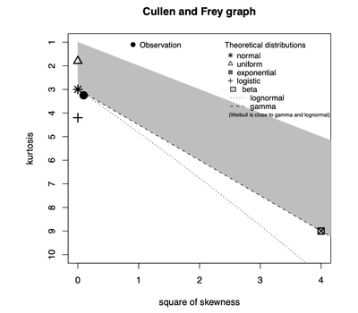

Cullen-Frey PlotCullen-Frey Plot

  • Cullen-Frey plots (also known as Pearson Plot) is just a way to plot the estimated skewness and kurtosis of a data set on a plot that shows the theoretical values (as curves on the plot) for the skewness and kurtosis for known distributions (normally exponential family distributions)

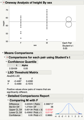

  • Gardner-Altman plots are a simple way to plot the effect size when comparing two groups.  You get similar information in the Fit Y by X (Oneway) analysis:
  • In JMP, you can already create a combined dot plot, box plot, and violin plot

Observing the distribution of the points is important to understand if there is the presence of multi-modality and in the Gardner-Altman plot observing the mean or the median with the relative confidence intervals (as shown in the paper by the two authors) would be very informative.
Cullen-Frey plot (or Pearson plot), the authors in their book write that they are not the inventors of this graph, it would not hurt to be able to implement it in JMP instead of having to do it with R.
