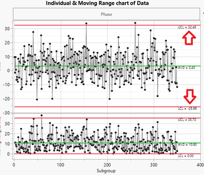

The  number of decimals shown in the UCL/LCL varies from chart to chart randomly.  I cannot find a way to set the number decimals manually.  @PatrickGiuliano suggested I submit this issue via the wish list. I feel it is a bug.

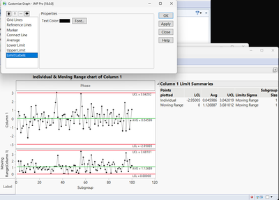

But currently the display format - other than the Font of these Limit Labels - is not controllable by the user as an option in the Platform, and the number of decimals displayed can vary, as Carl has indicated, and that variance will depend on the things like: the type of chart produced (e.g. I-MR vs X-bar&R) and the number of decimals displayed in the source data table Column for the response being graphed.

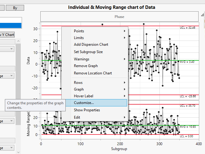

This Wish List Request includes a possible feature in the Red triangle menu in CC Builder (e.g. as a submenu option to the "Show Limit Labels" Option), and/or as a Right Click > Customize Option (where currently only Font is modifiable for the Limit labels):

Hello @MSN,  As of JMP 18 we do have an option under the red triangle menu in Control Chart Builder called "Limits Label Precision."  You can use that option to set the number of decimals displayed.

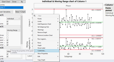

There is still no option to "customize" what you're seeing on a per-graph basis.  While Right Click > Customize... does have a "Limit Labels" attribute, there isn't any option to change the display resolution there -- only the font and text color.
