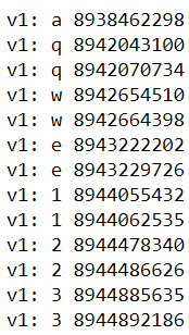

I wondered if it's due to pressing the key and relasing it again.
But  when you keep the key presses, the function is triggered again and again.
The result is particularly interesting when pressing return. Then it is:
hogi
Level XIII
I wondered which time it takes between the two triggers of the command - and by doing so, I found an easy solution:
just make the command slightly longer than show(key) - and it's just triggered 1x :)
The first function is triggerd twice:
uncommenting the second (slightly longer) function solves the problem:
