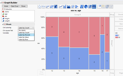

I am making Pareto/ mosaic charts and I would like to add more than one cell label, e.g. having percentage AND number of observations. So in the graph builder, it would be a series of tick boxes instead of a drop down menu to choose this.
I have tried doing this by adding a "cartridge plot" (the first one on the right of pareto plot),  as well as the Pareto chart in the graph builder but it just doesn't work well. The scale is resized in a random fashion and the graph becomes unreadable.
So far my solution is to make two charts, one with the percentages and one with the number of observations and put them both on the same slide in powerpoint...

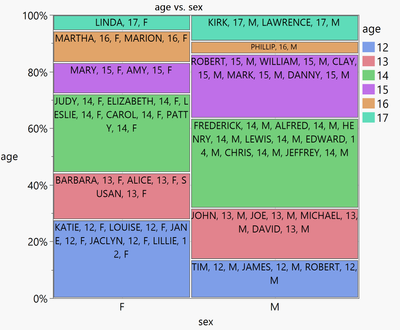

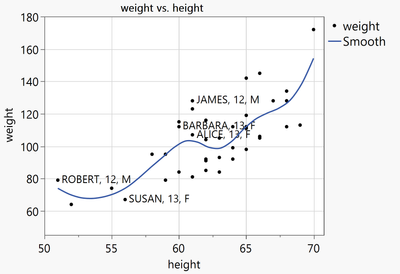

Actually, I need the inverse option:
Once a column is enabled as "label", labels will show up in ALL of my plots.
I need an option to enable/disable a specific column for a specific plot.
e.g. scatter plot: show sex and age. Mosaic plot: show names

What I need: For label by row ...
a way to activate/ deactivate individual column for the labels in a specific  plot:
Plot # 1: label = name
Plot#2: label = sex
To my understanding, this is not possible yet.

To add to the input @hogi  gave, I think the options to not only have the columns/row label but also multiple cell labels would be the intent.  the default is to only have one of these drop down options, however, these should be a check box where we could have any or all of the options on at once.  The current work around is to put the x axis items into the GROUP X axis and then use a caption box but that does not always produce the style of chart I want and also is more steps then should be needed.
