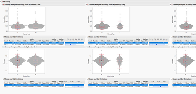

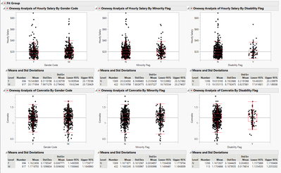

The JMP v17 release “forcibly” includes additional Means And StdDev() information on the One-Way platform which are not optional and cannot be disabled in the platform preferences.  This is an issue because it affects rendering (compared to JMP 16) in a way which is disruptive to efficient analysis and report generation.  New features should be introduced optionally and be controllable via Platform Preferences so that they are not disruptive.
The following script demonstrates the issue, using JMP SAMPLE data to perform one-way ANOVA and include a table of Means And StdDev’s:
dt=Open("$SAMPLE_DATA\Predicted Termination.jmp");
ow=dt<<Oneway(X(:Gender Code,:Minority Flag,:Disability Flag),Y(:Hourly Salary,:Comratio),BoxPlots(1),XAxisProportional(0),PointsJittered(1),MeansAndStdDev(1),MeanErrorBars(1),StdDevLines(1));
In JMP 16.2, the rendering easily fits on one screen and can be easily pasted into presentations:
In JMP 17, the MeansAndStdDev table was forcibly augmented with additional statistics display, instead of making the additional statistics optionally available.  The additional statistics result in a rendering that is not easily transferrable into presentations:
