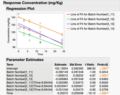

Using the sample data file Stability.JMP, if you fit the ANCOVA model, you get this output

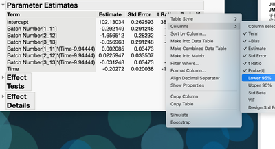

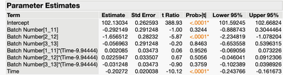

If you right click on the Parameter Estimates Table, you can turn on the display of the confidence intervals for the estimates, which includes the individual slopes

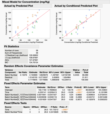

You can also do this if you include random effects in both Fit Least Squares and in JMP Pro's Fit Mixed platform.

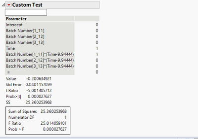

Thanks, but that is not quite what I am looking for. In order to get the individual slope estimates, you need to add the parameter estimate of Time to the parameter estimate of Batch*Time which can be done with the Estimates > Custom Test option
It would be nice to be able to include confidence intervals of the estimate to the output. In this simple case I should be able to calculate the confidence intervals myself from the Std error and degrees of freedom but it is still inconvenient. My version of JMP is 16.0.
