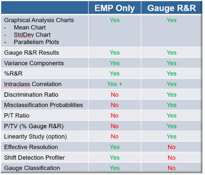

There are aspects in the Measurement Systems Analysis which we like for both the EMP and Gauge R&R methods.
We would like the ability to access the other analysis when we are in either one.
For example, if we use the EMP approach, we do not have the ability to enter a "standard" column nor specifications.  So, we can't perform a linearity study and we can't calculate the precision to tolerance ratio.
If we use Gauge R&R, we don't have access to the good EMP output of effective resolution, shift detection profiler, and Wheeler's gage classification system.
Both approaches have good aspects, so we would like to be able to perform the analysis in both without having to run both platforms separately.

Nice layout!
It's subtle, but worth noting that for the Gauge R&R results between the Variability Chart and MSA menus differ with how they incorporate the Interaction terms in crossed models to the Reproducibility portion. I like the output in Variability Chart more as it matches what I've seen most in the literature; in MSA they leave the Interaction as its own separate line item, not counting it towards the Reproducibility portion.

Great idea!
It makes good sense to combine these methods and take benefit from both. To increase transparency it might be beneficial to indicate in a footnote which method was used to derive the results. This could help expand the use of the EMP method, which for many is considered too different from the more traditional methods.

Status changed to: Yes, Stay Tuned!
These suggestions have been addressed in the EMP MSA platform in JMP 17. Thank you for the request, kudos, and comments! If you are a member of the JMP 17 EA program, please take a look and send feedback via [email protected].
