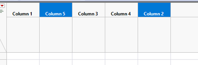

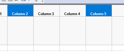

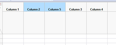

How do you think the column ordering should be done on the selected columns? Should the sorting only be done by using the selected columns, or should all the columns be moved together besides the first selected column (I have already written the code but I'll have to test it). Couple of images to explain what I'm asking:
Starting situation:
Sorting by name only inside selected columns:
Sort while grouping them together:

Regarding the behavior of column reordering for selected columns, I suggest that the default would be to reorder AND regroup the sorted columns and that there would be an option to leave the reordered columns in place.

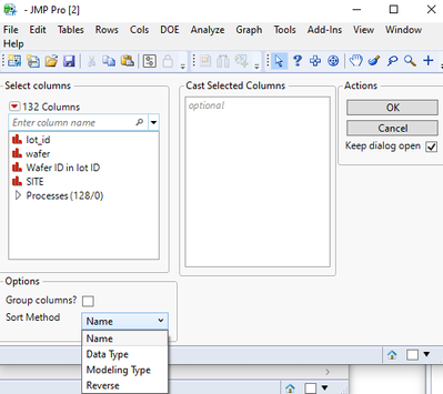

Ok, I'll try to figure out how to add some simple "settings" menu for that addin, because I think it is a bit unnecessary to open a menu when the script(s) is(are) launched.
Menu like this could be built, but I'm not sure if it is necessary:
It does already support those options, but user would have to make modifications which are in settings.json file inside the addin, that's why it needs some small UI to make the changes.

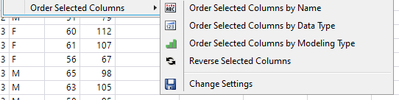

The addin should now be ready. I'll try to get post created to JMP Community's Discussion area today or during weekend with the addin after I have done some more testing.
After installation new submenu will be added to Add-Ins menu (it could be added to Cols menu, but even getting this to work as an addin was enough work and hassle for now).
Add-ins menu:
Settings window:
