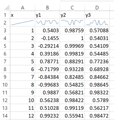

I really like the new feature in JMP 15 showing the distributions below the headers. Yet, for time series (sensor data), distributions are not enough.
It will be great if we can also add spark-lines (Excel and many other software have them).

JMP 17 is natively connecting to PI systems, sensor data needs this functionality in the header. Again, you can do this in Excel and more adv. stat software.

For sensor data, a histogram can be very misleading (e.g., oscillations can be perceived as gaussian noise). I think having the option to either show the histogram and/or sparklines will be enough. JMP competitors have had this option for years.

I will be happy to see this feature as well.  But I think it is misleading to say that Excel and other packages have this capability.  I can't speak to the other packages, but to do this in Excel, you need to create the sparklines - they don't appear automatically for columns or rows the way that the distributions appear in JMP for each column.  You can create sparklines in Graph Builder just as you can create them in other software.  We are talking about automatic creation for variables in a data set - I'd imagine that this will require some kind of dialog to instruct JMP to use a particular column as a time variable or use the row order as time.  Again, I would like to see this feature, but I think the characterization of this being available in other software but not in JMP, is unfair.
