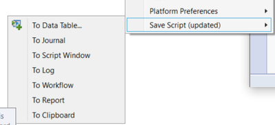

As many users use the command from the red-triangle menu
or the icon in the report toolbar:
one has to add a Shift - click option to trigger the verbose option ...
