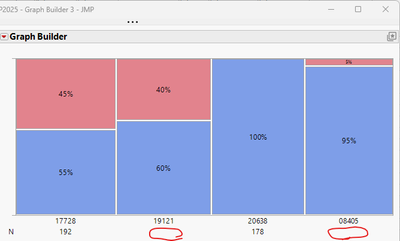

What inspired this wish list request? When I add a caption box to Graph Builder and select 'Axis Table' it defaults to 'Table Cell' format, but 'Table Cell' skips every other cell as shown in the screenshot. I'm using JMP 18.2.

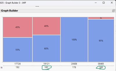

What is the improvement you would like to see? Please fix 'Table Cell' to not skip cells or change the default to another option which all work fine. See the screenshots below for how 'Interval Tray' fixes the issue.
Why is this idea important?  It is helpful to show the count of rows (N) included in summarized graphs. I use a lot of Mosaic Plots to show nominal data and JMP can either label the cells by percent or count but not both (If JMP could label them by both this would fix the issue too), so having the caption box display the count on an Axis Table is great, but the default 'Table Cell' format does not work.
