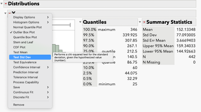

Hi @MShroff, most of the calculators in the Sample Index are also natively available from JMP Platforms if you're working with raw data. The hypothesis test for one standard deviation is available from the Distribution platform. Does this meet your needs?
