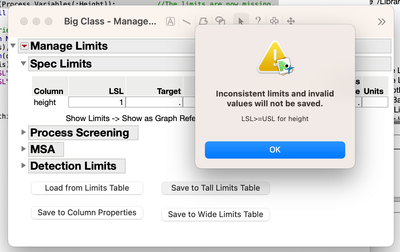

Apologies for the oversight.  This would explain why I was having difficulty using the << Set Properties and << Get Properties messages.  I now see that I *can* read the limits back using the Manage Limits window.  However, I do still get the following pop-up when Manage Limits is opened:

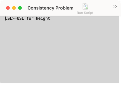

Moreover, if I try to "Save to Tall Limits Table", I get this error:

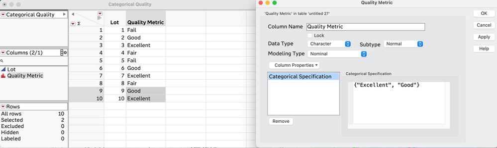

Hi @nikles I read the related community discussion thread and this request.  It seems to me what you really need is a way to define and store a "categorical specification".  For example, if the test of the product simply produces a Pass/Fail result, and "Pass" is the specification, you want to be able to store that as the specification in a column property.  I could see also other types of categorical specifications, such as the test result is Excellent, Good, Poor, Fail, and "Excellent" or "Good" is the passing specification.
Currently the USL and LSL for the Specification Limits column property is intended to be for continuous responses and because of that it doesn't make sense for LSL>=LSL.   The Manage Limits platform under Analyze > Quality and Process is intended to manage limits used in JMP analyses.  I'm not aware of any JMP platforms that utilize a categorical limit like this.
For your immediate need, you could create a custom column property (Choose "Other" under column properties) to store the categorical specification.  Or you could use << Set Property( ) message in JSL on the data table.    Then you could utilize that property in your scripts.
