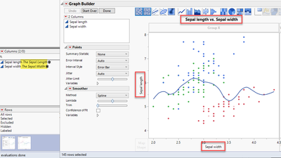

Hi @ih! I am curious if using name-label pairs would help fulfill this wish? If you read the documentation on the Show Alternate Column Name preference, it will give you information on how to use this feature. I don't think it provides everything you have asked for but please let me know if it is helpful.

Not quite.  Although that will put a more descriptive name next to the column name in some places, I really want the default label in charts and graphs to be more useful.  For example for some audiences these labels should say 'The Sepal Length', for others 'Sepal Length (cm)', and 'Measurement34' for a differnet group.
