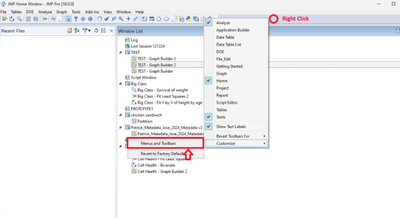

From either the JMP Home Window or any JMP Window (you'll be able to add this icon in both places if you want),
Right Click > Customize > Menus and Toolbars:

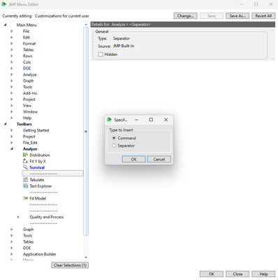

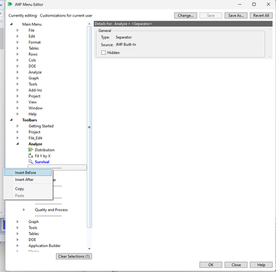

Go to the Analyze submenu right click over one of the menu items in the Menu display tree in the panel on the left hand side of the JMP Menu Editor window,
then select > Insert  Before or > Insert After.
Click the command Command radio button, then click OK:

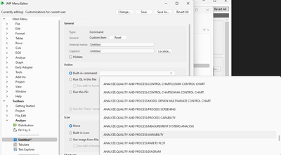

Go straight to the Built-in Command Action (ensure the radio button is selected for "Built-in command"), then select the one you want from the dropdown menu corresponding to that selection:

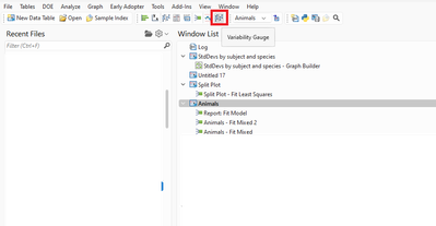

Click OK and the shortcut will be added:
