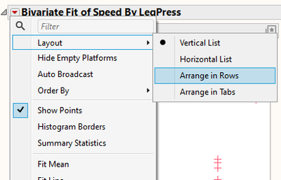

danschikore
Staff
In JMP 18, By groups for any platform that does not create a Fit Group will create a Group Platform object.
Names Default To Here( 1 );
Open( "$SAMPLE_DATA/Football.jmp" ) << Bivariate(
	Y( :Speed ),
	X( :LegPress ),
	By( :Position )
Group Platform offers an Arrange in Rows option, in addition to other group features.  Because this type of launch always includes platforms of the same type, it also provides group menu options that will broadcast commands to each of the platforms in the group.
