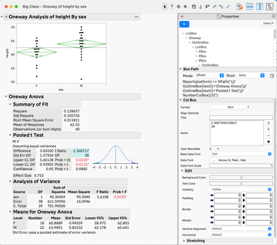

@jthi can you explain a little more why you need this?  Do you want to get at the XML so that you where in the report structure certain information is located?
Also, in case you were not aware, you can see the Xpath to a display element by using Show Properties in the report window and expanding the Box Path and choosing Xpath as the mode.

Basically what that script does is what I would like to have at minimum (script doesn't work for me, I suspect << Language() is upcoming JMP18 feature for New Window?). Using Properties XPath isn't enough as it isn't robust enough for general use (in my opinion). This would just make it a bit faster when customizing / getting information / manipulating JMP reports and provide additional option outside Properties toolbar button. Of course if this was to be linked to report it would be even better
