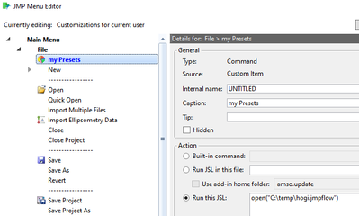

You can add a shortcut to a Workflow to any menu - this can also be used in AddIns:
(view in My Videos)
