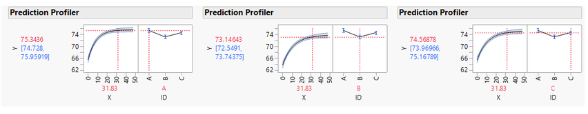

What inspired this wish list request? I have recently been fitting Mechanistic Growth models in the Fit Curve platform.  While confidence intervals for the fit are visible in the Prediction Profiler, there is no way to save those formulas to the table.  I can only visualize the results for one batch at a time, and there seems to be no ability to generate or visualize the confidence curves for the individuals at all.

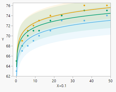

What is the improvement you would like to see? I would like the ability to save the "Mean Confidence Limit Formula" and "Indiv Confidence Limit Formula" out of the Fit Curve platform for any models where it is mathematically possible.  (I used the same nomenclature as what is present in the Fit Model>>Save Columns menu, but it seems to vary by platform.)  Ultimately, I would like to be able to overlay confidence curves - both for the fit and the individual points - similar to what can be accomplished in the Fit Y By X platform.  I could create a visualizations like these in Graph Builder if I could save the formulas for the confidence curves for both the fit and the individuals out to the table.
