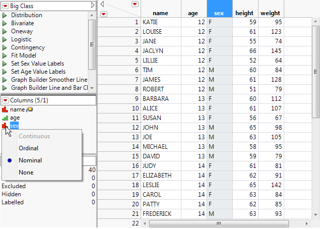

To change the modeling type to Continuous, Nominal, Ordinal, or None:
  1. Open the data table.
  2. In the Columns panel, right-click the modeling type icon for the column that you want to change and select the new modeling type.
Changing Modeling Type Through Data TableChanging Modeling Type Through Data Table

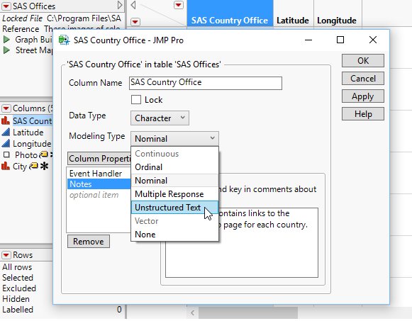

To change the modeling type to Multiple Response, Unstructured Text, or Vector:
  2. Right-click on the column whose modeling type you want to change, and select Column Info.
  3. Next to Modeling Type, select the new modeling type.
Changing Modeling Type Through Column InfoChanging Modeling Type Through Column Info
