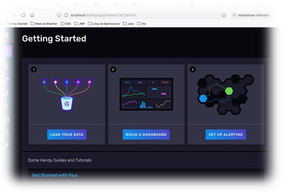

To begin, I installed InfluxDB using HomeBrew and then using InfluxDB’s DataExplorer, I created
I created a Bucket and uploaded data.

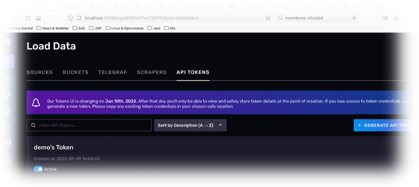

I then had to navigate to the API Tokens page in order to create an API Token I can use with the REST communication.

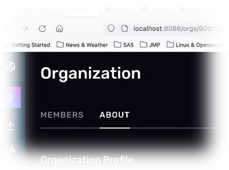

And navigate to the Organization page for the org_id

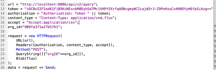

Finally, I was able to get JMP and InfluxDB chatting with JSL.
And this JSL snippet was really all it needed.
  • url -  the location of my InfluxDB server
  • token - the token I obtained from my API Token page
  • authorization - the header that gets passed in every communication to InfluxDB
  • content_type - tells InfluxDB that I am passing a flux script (in this case, previously defined)
  • accept - tells InfluxDB that I’d like a csv file in return (please)
  • org_id - the organization id from the Organization page.
It is worth noting that line 24 is
  • Blob(flux)
Using Blob allows me to set the content type to
  • Content-Type: application/vnd.flux
This is what the InfluxDB is looking for. Using Blob allows me to set a content type to pretty much anything, whereas using Text, JSON, or XML will set the appropriate content type or allow you to only set compatible content types.
