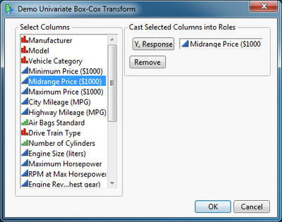

Simply open the data table with the variable to be transformed and then open and run the script. I am using the Midrange Price variable in the Cars 1993 data table as my example. Select the data column, click Y, Response, and then click OK.

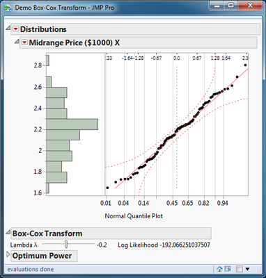

You can see in both plots that this variable exhibits a strong right skew. The log likelihood is -210.415 when the power is 1. Use the slider to change the power between -2 and 2 in 0.1 steps. The lambda value -0.2 results in the highest value of the log likelihood (-192.066).Changing lambda with the slider updates the new data column. This change in turn updates the plots because the Auto Recalc feature of Distribution is turned on.

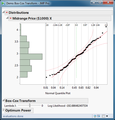

A good general practice is to round the value to the nearest whole number (0, 1, 2, et cetera) or reciprocal whole number (1/2, 1/3, et cetera) because this value usually has a physical interpretation or foundation. In this example, 0 is a good choice for lambda. This power is equivalent to the log transform and yields a slightly lower log likelihood (-192.686) and no appreciable loss of linearity in the normal quantile plot.
