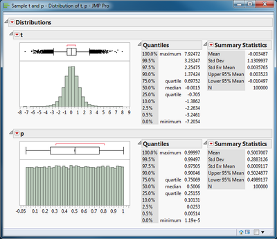

Simply open and run the script. The first time, I will simulate the case where the null hypothesis is true. In this example, an important property of the final preparation is the pH. It should be 6 (H0: mean pH = 6). The simulated population of preparation pH values has a mean of 6 and a standard deviation of 0.1 pH. I obtain the pH for 12 preparations. I will simulate 100,000 samples and obtain the t statistic and its p-value for each sample. The following dialog includes all of the correct parameters for this simulation.

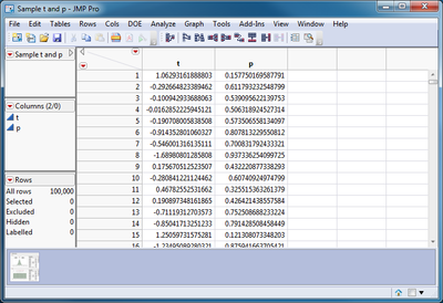

The results for each sample appears on separate rows.
The sampling distribution of the t statistic and its p-value are displayed in a Distribution platform. There are two important features to be noted here. First, the t statistic is symmetrically distributed when the null hypothesis is true. Second, the p-value is uniformly distributed when the null hypothesis is true. That uniformity is why the rule of rejecting the null hypothesis when the p-value less than the significance level leads to a probability of a type I error equal to the chosen significance level.

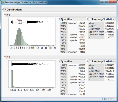

I will repeat this demonstration. This time, I will simulate the case where the alternative hypothesis is true. The only change is that simulated population of preparation pH values has a mean of 6.1. I again obtain the pH for 12 preparations. I will simulate 100,000 samples and obtain the t statistic and its p-value for each sample. The following dialog includes all of the correct parameters for the second simulation.
The two main features dramatically changed. The sample t statistic is no longer symmetric. This shape is known as the non-central t distribution. The p-value is no longer uniformly distributed. Many results are now below the level of significance, more than 90%. This shows the power of this test when the change in the mean is equal to one standard deviation and the sample size is 12.
