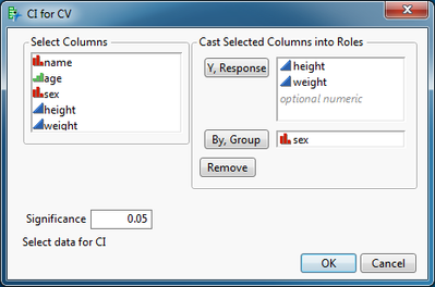

This script opens a Distribution platform and adds the confidence interval for the coefficient of variation to the report. Simply open the data table with the columns to be analyzed and then open and run the script. Select the columns for analysis and click Y, Response. Select the grouping column and click By, Group if necessary. Specify the significance level and click OK:
