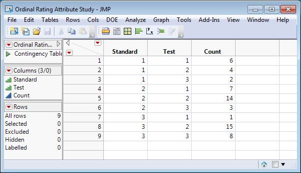

Open the data table, then open and run the script. Each rating may entered on a separate row or a count may be used in the Freq analysis role. One column must indicate the true rating and another column indicates the test rating to be evaluated.. Here is a simple example for illustration:

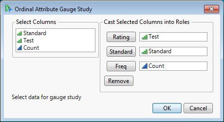

Standard is the true rating and Test is the result for evaluation. Run the script and enter the data columns in the proper analysis roles:

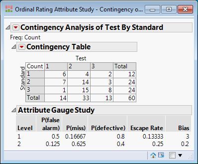

Click OK and the results appear at the bottom of a standard Contingency platform window:
