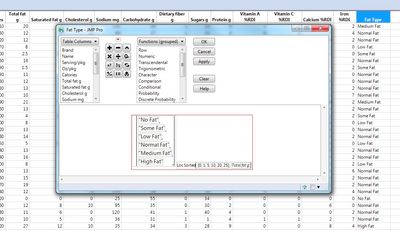

So with this data table opened  I’m going to create a New Column by double clicking a blank header.
I’ll rename it to “Fat Type” by double clicking the Column header again.
From Column Info I’ll select “Character” because I’ll use a text string.
Then I’ll add a Formula to Lookup a range of values and assign a category based on the value.

loc sorted([0,1,5,10,20,25],:Total fat g)
To return the value found for each row in the lookup column and write it to the "Fat Type" column we use the row subscript function.
Simply enclose the loc sorted function within a square bracket ”[“ and an end with right bracket "]" as shown here.
[Loc Sorted([0, 1, 5, 10, 20, 25], :Total fat g)]
And here is the full script you can copy.
Not Narrated
{"No Fat", "Some Fat", "Low Fat", "Normal Fat", "Medium Fat", "High Fat"}[Loc Sorted([0, 1, 5, 10, 20, 25], :Total fat g)]
In the Formula Editor, paste that full script   and click apply.
Here is our new Column that lookups and organizes the Total Fat measurements column into six ranges.
You can now it for yourself by changing the matrix values with the linked data table below or your own data and enjoy using JMP.
