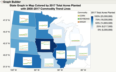

Graph in Map (Trend Lines in Geographic Map)
scwise
Staff
Data and Scripts from Scott Wise's Blog: "Soy What? Where is the Wheat?"
See Full Blog: https://community.jmp.com/t5/Scott-Wise-s-Blog/Soy-What-Where-is-the-Wheat-Advanced-Graph-Exploratio...
Platform: JMP 14
Why Desired:
- Allows easy comparison on a Map via another Graph Type
- While still allowing Map Coloring comparisons via another measure
Tips to Make Graph:
- Make use of Graph "Make Into Data Table" command to build Table of Graph Markers
- Graph Builder Tips: Enable "Use for Marker" command to bring Graph Markers into Map
