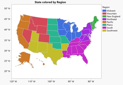

  • Left: Region (Nominal) was dropped in the Color zone.

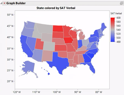

  • Middle: SAT Verbal (Continuous) was dropped in the Color zone.

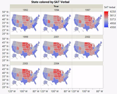

  • Right: Total Rate was dropped in the Color zone, and Year (Continuous) was dropped in the Wrap zone.
