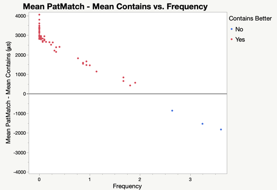

Clearly, the iterative approach using Contains and pattern matching approach are superior methods for searching long strings. But which method, and when? Since the testing was done using different substrings, some indication of how substring frequency (# occurrences*1000/29,903) may affect search time. The plot below shows a crossover point somewhere around a frequency of 2 substrings per 1,000 characters. Because all testing was done on the same covid19 genome string, however, it is unclear how search time is affected by searched string length.

To find the answers to these questions, and to explore possible interactions between factors, I ran an experiment using a space-filling design, varying searched string length (10,000 – 500,000 characters), substring length (2 – 21 characters), and frequency (0.75 – 3 substrings per 1,000 characters). 125 runs were generated using a Fast Flexible design with fractional string length values rounded. For each run, a random string of alphabetical characters was generated. Within that string, a substring made up of randomly generated numbers was inserted at random locations. Because frequency values could lead to a non-integer number of insertions, the number of insertions was taken as the ceiling of the frequency times the searched string length divided by 1,000. Each run was repeated 10 times on the same searched string/substring combination. The code used to generate the runs is in Execute Design Script.JSL and results are in Space Filling Results 1.JMP attached to this post.
A quick inspection of the results shows only 13 observations where the Contains method outperforms pattern matching. Of these, the largest difference is about 4,000 microseconds faster (whereas pattern matching was as much as 0.72 seconds faster than Contains). Fitting a Gaussian Process model to the data suggests that searched string length had the largest effect with a strong frequency by searched string length interaction. Substring length had little effect. A linear model was initially fit to the data, but residuals analysis suggested that the fit might be questionable. I have posted an interactive version of the Profiler for this and the follow up models to JMP Public.
A second space-filling design was created to get better representation of cases where Contains outperformed pattern matching. For this experiment, the ranges for both string lengths remained as before and frequency was varied between 0 and 1. The results are in Space Filling Results 2.JMP. The direction of the results was similar to before with longer searched string lengths and higher frequencies favoring pattern matching.
Combining both sets of results and fitting a Gaussian Process model suggests that for strings of 50,000 characters, Contains is superior if frequencies are below 2. At 100,000 characters, the frequency drops to 1 and at 200,000 characters, below 0.5. The conclusion from this is that for sparser shorter strings, use Contains and as string length and density increases, pattern matching will be superior.
