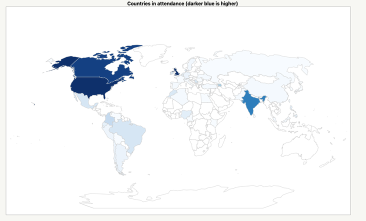

Recently, JMP partnered with the Royal Society of Chemistry and Chemistry World to hold a weeklong series of seminars on experimental design.
The series was, ostensibly, supposed to be for the eastern and western United States, but, as the attendee map below shows, well – things got a little out of hand on that point.
The seminar series included a panel of JMP experts who would answer questions submitted by the audience. With between 600 and 900 participants in each session, it was challenging to answer all the questions in the flow of the event. And there were a lot of them – on the order of 400 questions in the live session, with even more in the offline environment.

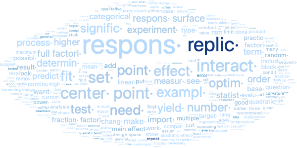

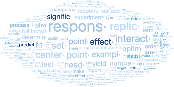

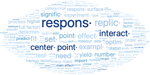

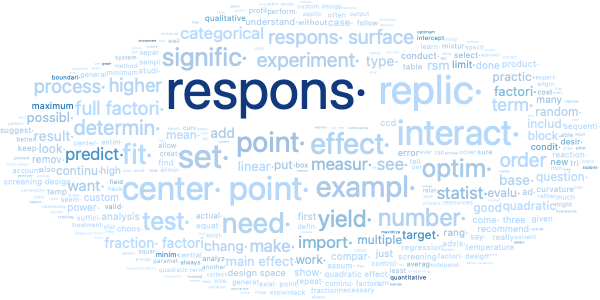

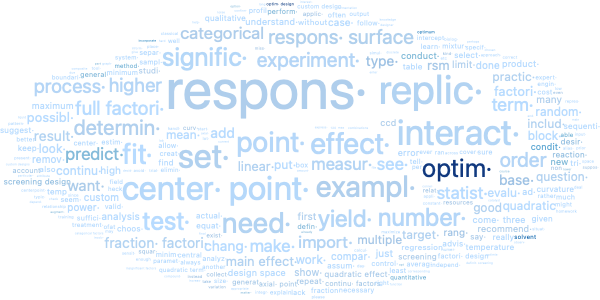

Once the team had recovered (and the joint liniment had done its magic), we got together and looked through the questions for trends to put in the series’ FAQs on the web. In true JMP fashion, we ran these questions through Text Explorer and came up with the top five. Here they are, along with our answers:
