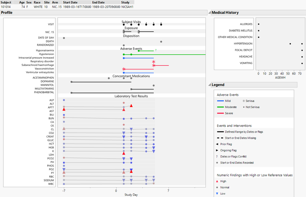

To better understand the content in a narrative, it may help to visualize some of the clinical trial data associated with a subject. The patient profile (shown below) may be used to show adverse events along with other relevant clinical data. It contains much of the same information as in a narrative but in graphical form. I will use subject 101014 as an example throughout this blog post for consistency so that you may recognize the differences in presentation of our semi-automated adverse event narratives. There are quite a few adverse events experienced by the subject, three of which are serious denoted with an asterisk, and two of these are concurrent and classified as fatal.
Patient profile of subject 101014 created by JMP ClinicalPatient profile of subject 101014 created by JMP Clinical

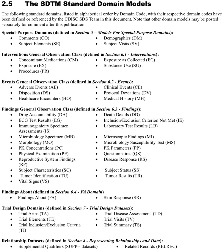

Supplemental sources may include the Council for International Organizations of Medical Sciences forms (CIOMS), Case Report Forms (CRF), MedWatch forms, as well as information from other external systems for tracking adverse event data, concomitant medications as well as exposure data. Many organizations are implementing their clinical database using the Clinical Data Interchange Standards Consortium (CDISC) models such as the Submission Data Tabulation Model (SDTM) https://www.cdisc.org/standards/foundational/sdtmig. JMP Clinical uses most of the domains shown from section 2.5 of the SDTM Implementation Guide below:
Section 2.5 from the SDTM Implementation Guide showing the data (domains) available to adverse event narratives.Section 2.5 from the SDTM Implementation Guide showing the data (domains) available to adverse event narratives.

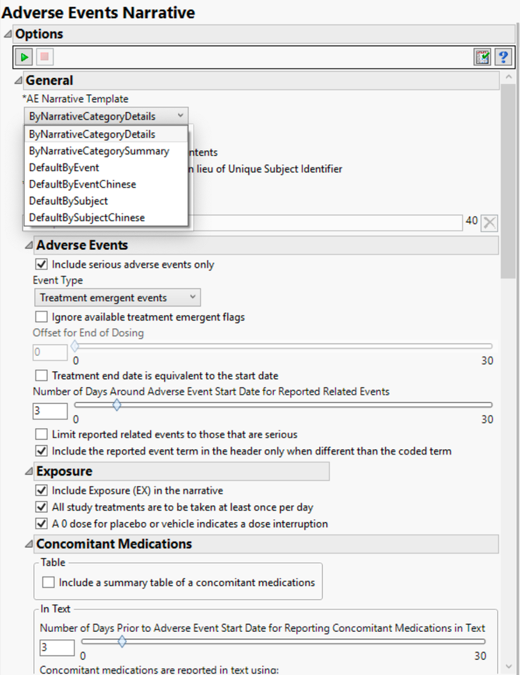

In a much earlier version of JMP Clinical, version 4, we introduced the ability to create adverse event narratives with options to select whether the user just wanted to print serious adverse events or all all adverse events as well as deciding whether to just print treatment emergent events or pre-treatment, post-treatment, etc. These options, available from dialogs (as shown below) in the software, provided flexibility for the end user to decide which content they preferred in their safety narratives. Now with JMP Clinical 7.1, these options have increased due to customer requests.
Dialog options for adverse event narratives in JMP ClinicalDialog options for adverse event narratives in JMP Clinical

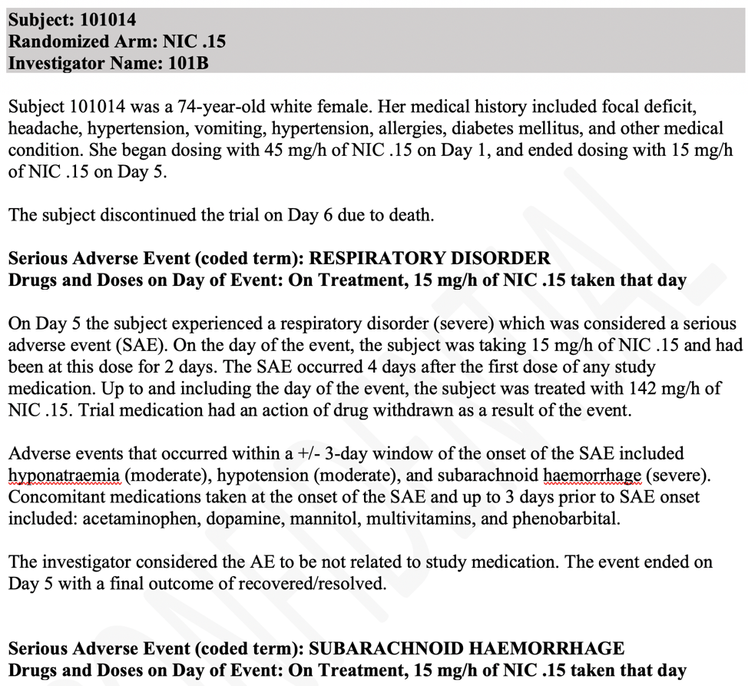

When selecting the “DefaultByEvent” template with one of the selected studies in JMP Clinical, the following example is generated. Each event, in this case a fatal subarachnoid haemorrhage, is printed in the following manner. A header displays demographic and exposure details, followed by a heading in bold of the adverse event. The first paragraph provides more detail of demographics, medical history, exposure and outcome. The second paragraph describes the adverse event in detail, with the exposure at the time of the event, followed by the action taken with the drug. The third paragraph describes the other adverse events that occurred within a specified number of days (window around the current event) as well as the medications taken within a similar or different time window. The last paragraph details the causality and outcome of the adverse event. Not shown are optional paragraphs to detail laboratory or other findings data details relevant to the adverse event.
Example of a serious adverse event narrative using the "by event" template.Example of a serious adverse event narrative using the "by event" template.
This example, while a little updated with newer features, was the first type of narrative requested by customers. Over the following years, it became clear that many of our customers preferred to group all of the events that a participant exhibited under one header in the order that they occurred relative to study day 1. The next example below shows this approach with our “DefaultBySubject” template. For comparison, I use the same patient as in the above example, so that you can see the relative differences in organization under a single patient header in grey.
Example of an adverse event narrative in JMP Clinical using the "by subject" templateExample of an adverse event narrative in JMP Clinical using the "by subject" template

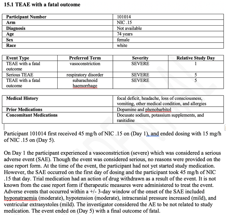

Upon seeing these more organized "by subject" narratives, customers asked for a clear and concise summary of each participant using tables formatted to indicate 1) demographic information, 2) adverse events sorted by severity of event type and then study day, and finally another table for medical history with concomittant medications and additional information for oncology therapies.
Example of an adverse event narrative from JMP Clinical using the "by narrative category details" template.Example of an adverse event narrative from JMP Clinical using the "by narrative category details" template.

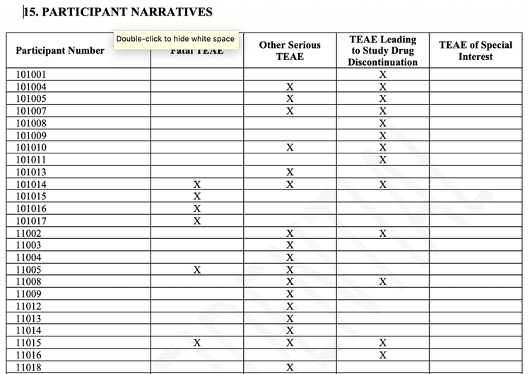

Notice that participant number 101014, shown in the examples above, falls into multiple adverse event categories and will appear in the fatality section of the document since they had at least one fatal adverse event. Customers have requested that we start organizing the adverse event narrative document by the categories of fatal, serious but not fatal, non-serious leading to discontinuation and special interest. These features get us one step closer towards semi-automating the entire adverse event narrative section of the clinical study report. In order to accomplish this, we need to summarize all participants with an event in a way that the reader can quickly assess them and the categories into which they fall. See the example below:
Example of an adverse event narrative from JMP Clinical using the "by narrative category summary" template.Example of an adverse event narrative from JMP Clinical using the "by narrative category summary" template.
