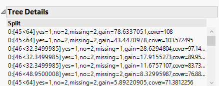

hi Russ,
I am using JMP 16 Pro. I loved your work.
I am having trouble though in getting any Tree Details. The white space expands but nothing comes up.
Do you know the solution ? I think I downloaded the addin a few weeks back, has there been an update since then ?
thx.
hi Russ,
Could you pls address my prior question. I am unable to get any trees from your XGboost - Pro 16 and 18EA both did not deliver.
Hi @altug_bayram   Apologies for the delay.   When clicking a model red triangle > Tree Details, you should see a new outline box at the end of the output.   The attached image is from the Press Banding example that comes with the add-in.   Does this example work for you?
Another related idea is to click red triangle > Save Prediction Formula and then examine the formula of the newly created column to see the logic of the prediction.   If still not working, please feel free to email data and model to russ.wolfinger@jmp.com and I can take a look.
This outline is coming out but is difficult to translate as parameters are replaced by indexes.
Do they refer to the ordering under Importances or something else ?
Isn't it possible to get regular tree diagrams (as would be produced by Bootstrap Forest for instance ) ?
Also, my addin is not under regular JMP directory structure but rather under an independent windows folder. Should I remove/reinstall ?
Also, having confirmed that I see the outline (but difficult to translate) , is there any advantage to gain by using 18 Pro EA as opposed to 16 Pro ?
thx.
hi...
I cannot send you any data or model.
Do you have any samples that show how to interpret the tree details. As these are not in the standard tree diagrams, it is difficult to understand w/o some sort of example.
Hi @altug_bayram     The add-in parses these strings in C++ code to extract the tree splitting rules and variable importance values.   I think the first number is the 0-based index of the predictor X variable in the order specified for the model.   I'm not aware of any official doc about them--we deduced parsing rules after studying them.   The add-in currently offers no way to plot the trees as there are typically hundreds of them in a k-fold fit, but as I mentioned, the logic is shown in the prediction formula which is presented similar to a tree if you save the prediction formula then click on it    Also, the following R package looks like it plots the trees in case you want to try it:   https://rdrr.io/cran/xgboost/man/xgb.plot.tree.html
Add-ins are installed in a folder separate from the JMP installation location to ensure you have write permissions.
There have been a lot of improvements to the add-in since version 16--please scroll back through this thread to see posts about them.    Assuming one of your goals is to interpret what the model is doing, some very useful outputs in this regard are Shapley values.   They break down each row's prediction into components attributable to each variable.   It can be very informative to plot Shapley values versus the variable they correspond to.  You can obtain Shapley values by clicking a model red triangle > Save SHAPs.

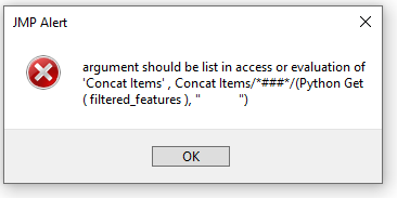

Russ,
You can ignore my prior question. The link I posted above does not contain the latest addin, it is the prior version. I have figured the location of the latest.
However, I am constantly getting an error running through a sample data of yours. See below. After a window "Most Important Parameters" window launches and completely empty.
Hi Russ and @Franck_R
I have tried several different things trying to to run the new xgboost from
https://community.jmp.com/t5/JMP-Add-Ins/Machine-Learning-with-XGBoost/ta-p/266205#U266205
XGBoost_Analysis_new_release.jmpaddin
tried w/ different sets of data ..
tried classification and regression
I cannot seem to pass the error I reported earlier (see below).
I use JMP Pro 17 and Python 3.12 - all libraries installed.
Much appreciate a response as I like to really try this new version as soon as possible.
note: I was able to use prior version fine.
hi @russ_wolfinger
message here for you in regards to new xgboost version
Franck_R
Hi @altug_bayram I'm not sure what your problem is because there are 2 different things in terms of XGBoost functionality for JMP:
Russ created a xgboost functionnality for JMP Pro, it's an official functionnality and it's the thread you're writing on
I created a xgboost functionnality for JMP standard, it's an unofficial functionnality (and I'm not part of SAS or JMP team)
As the error mentions python, I assume it's my addin that is faulty on your computer. If that's the case, it could be due to a number of things: a library that isn't exactly the same as mine, for example: there are many things that are regularly deprecated. Normally it works with JMP 17 standard and python 3.12 I use it often (not tested on JMP 18 though) but I can't test the very new libraries since I've changed company and my PC is now completly locked in terms of software and updates.
I'll try to see in my code if I see a concatenation that could cause a problem, but I can't guarantee a short term answer if I can't reproduce the errormyself. Sorry I can't commit more as I developed this addin in my spare time.
Alternatively, given that you have JMP Pro, perhaps the XGBoost feature would be more appropriate? I'm not supported by a team of IT developers, but they are! lol
