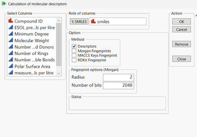

  1.  「アドイン」>「Toolkit for Materials Informatics」>「Descriptor Calculation」を選択します。
  2.  SMILESが入力されている列を「Y,SMILES」に指定します。手法の選択の一覧から生成したい、記述子、フィンガープリントにチェックを入れます。
  3.  「OK」ボタンをクリックすると、選択した特徴量が生成されます。
  4.  「閉じる」ボタンをクリックします。

  1.  Select Add-ins > Toolkit for Materials Informatics > Descriptor Calculation.
  2.  Specify the column in which SMILES is entered as "Y,SMILES". Check the descriptors and fingerprints you want to generate from the list of method selections.

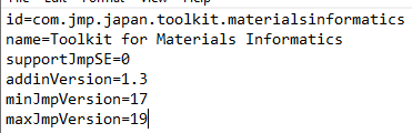

I've just started to use the JMP 19EA version and I get this message. Is there a way to update the add-in to enable it to run? the Python packages has been installed and I get the green ticks for these so I don't believe that this is the problem.
hogi
can be done manually:
rename the .jmpaddin to .zip, open AddIn.def and change to:
Hello @d_barnett , Thanks for trying this add-in. I am updating the add-in to be able to use it with JMP 19. I have noticed that if I use an older version of RDKit, JMP crashes. If you are experiencing this crash, please update RDKit.
