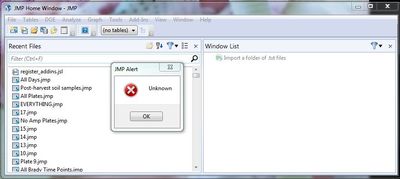

Thanks for posting this Heath. Quick question, I installed the add-in everything seemed fine, checked to make sure visual basic macros were enabled and went to test it out. I tried importing powerpoint, word and text files. In all cases everything seems to be working but then right at the end I get the error message below and no new data table is created. Any idea of how to fix this?

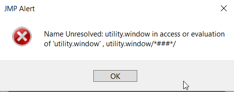

I installed the addin using word 2016 with JMP15.2 on Win10 and try to open pdf Files.
I get the following in the log window:
Name Unresolved: utility.window in access or evaluation of 'utility.window' , utility.window/*###*/
"Waiting for Word to finish conversion..."
and an alert window.
Then nothing happens.
Any Idea how to solve the problem?

Hi @mlo1 ,
I’ve started using the File>Import Multiple File tool in JMP and it works great. It has lots of configuration options and I’ve used it to create a Corpus from a few different folders worth of PDFs successfully. I hope this helps.
