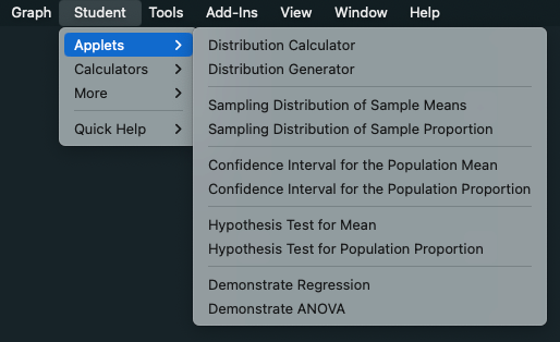

This add-in adds a Student menu item to JMP that contains a variety of interactive applets for teaching core statistical concepts, such as sampling distributions and confidence intervals, as well as calculators for confidence intervals, hypothesis tests, and sample size calculations.
Once installed, the  Student menu item that will appear between Graph and Tools. Note that if you cannot install the add-in, the teaching applets and calculators can also be found in JMP under Help > Sample Index.
