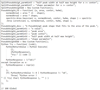

i just noticed that this add-in creates a large number (104) global symbols related to the custom functions that are specified and that this add-in uses.
Looking at the code, I think this could be improved by just adding "Name Default to Here(1);" statement at the beginning of the function definition files. The custom functions are still created, but no global symbols are created.
