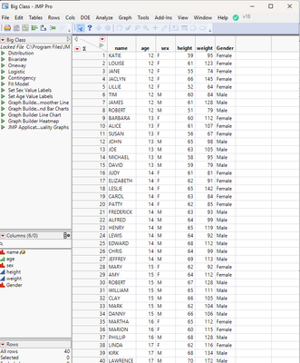

Here is an example using Get Rows Where
names default to here(1);
dt =
// Open Data Table: Big Class.jmp
// → Data Table( "Big Class" )
Open( "$SAMPLE_DATA/Big Class.jmp" );
dt << new column("Gender", character);
theRows = dt << get rows where(:sex == "F");
:Gender[theRows] = "Female";
theRows = dt << get rows where(:sex == "M");
:Gender[theRows] = "Male";
