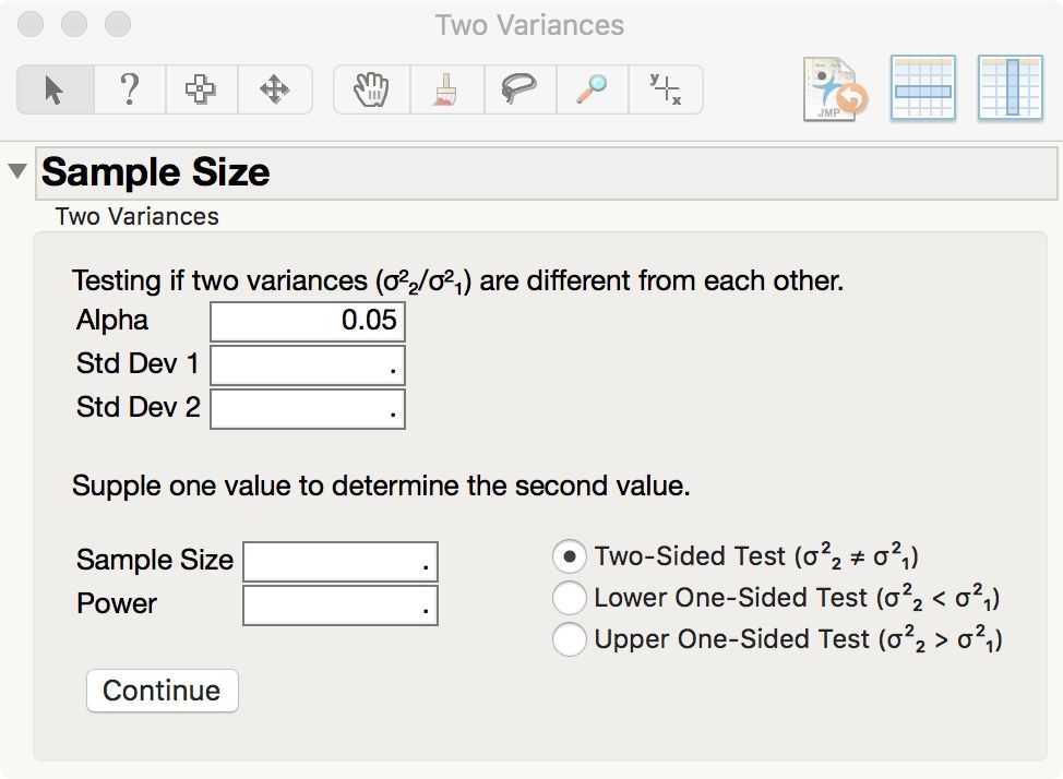

The initial window includes a default significance level. Enter two standard deviations that represent the minimum difference that is important. Std Dev 1 represents the control population and Std Dev 2 represents the treatment population. Finally, enter either the sample size to estimate the power or the power to estimate the sample size and click Continue.
Note that this version provides the result for a balanced design. That is, both groups have the same size and the value entered or returned here is the total sample size or twice the size of each group. For example, if you enter 50, then the computation assigns 25 to each group.
The default test is two-sided for any difference. You may select either the lower or upper one-sided test instead. Be sure to enter the standard deviation values in the correct order.

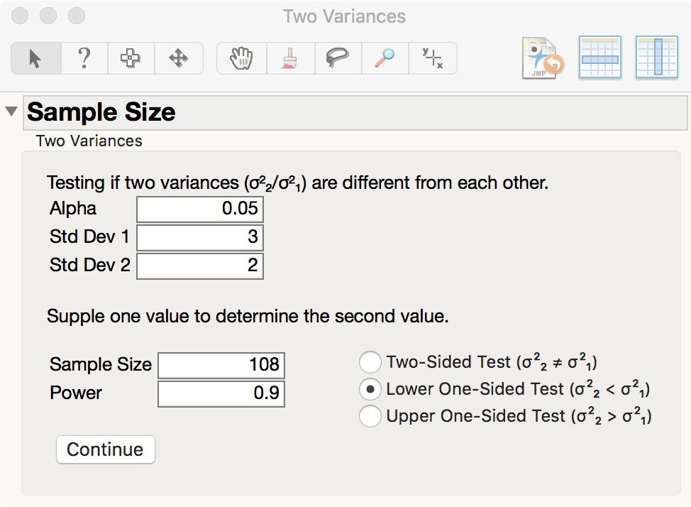

For example, a confirmation is planned to demonstrate that recent improvements have reduced variation for an original standard deviation of 3 down to 2 based on a lower one-sided test with 90% power. The result is shown here:

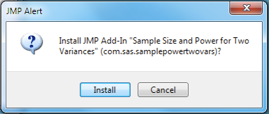

I'm sorry you're having trouble. When you click the link above your browser should download a .jmpaddin file.
When you double click on the .jmpaddin JMP should open and prompt you to ask if you want to install the add-in.
After you install it you'll find the menu option in your Add-Ins menu.
If these steps don't help, post back and let me know where you're running into trouble and I'll try to assist further.

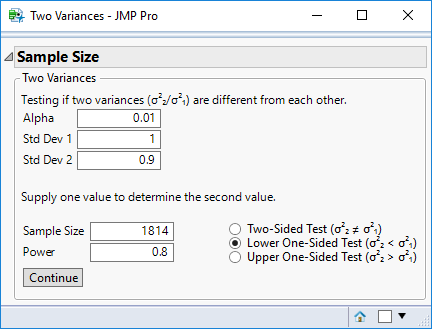

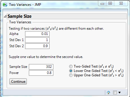

1) see the first attached image. The sample size should be 1814 for this example. I entered in the Power and clicked "Continue" and 302 was generated in the Sample Size box.

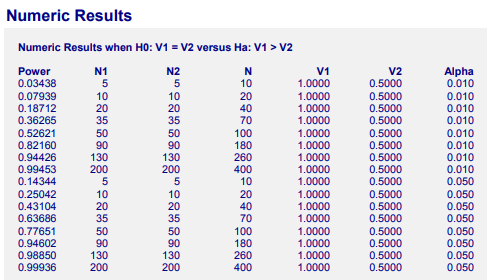

2.1) The source is linked: NCSS document table and I have attached the table I used as the second image below. The first 4 values are different. I also cannot speak to its validity, so when I saw that it disagreed with the JMP tool I found an online guide for an excel tool to check the numbers, which I replicated. The table and the excel functions got the same results, which differ from the JMP tool.

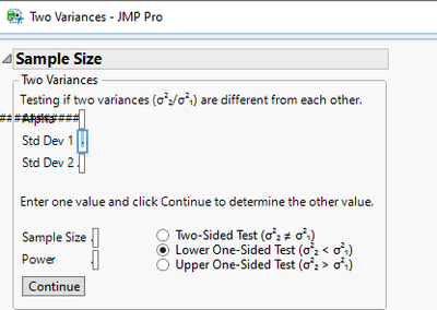

Hello, i have just installed a got this bug, could anyone help me to fix it
Regards
