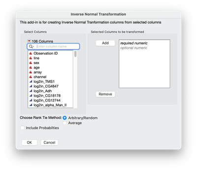

This JMP Add-in is to transform non-normal quantitative trait data typically analyzed in Genome Wide Association Studies (GWAS). The method implemented is rank-based inverse normal transformation (INT).
A simple interface is create to choose the traits to be transformed and then clicking OK to create new transformed columns (see screen shot below).
The output is two sets of columns: 1) _INT as a suffix. These are the transformed trait values 2) _p as a suffix. These are the probability values of the transformed columns.

UPDATE: Version 2 of the add-in includes the below:
  1. Added option to include or not include probabilities
  2. Added an option to choose between Arbitrary or Average when there is a tie.  Tie method chosen will write a note to the data table as to which method was used.

Thank you for such a useful add-in. I have two questions:
1. when I used this add-in to transform the data it adds two columns to the dataset. One with "_INT" at the end of the variable name and another one with "_p". What is the second one ending with _p?
 2. The paper that you have cited (McCaw et al., 2020) introduces two methods for inverse normal transformation; direct (D) and indirect (I) and then combine them to an omnibus test (O). I assume you only referred to the paper for more guidance for transformation. But in case the column is somehow related to one these three tests I appreciate if you can clarify which of them is used in the add-in.

HI @SoheilShapouri,
_INT columns are the transformed columns, _p columns are the probability values.
Yes, the paper was more for reference as to the reasoning for the add-in and guidance. What was implemented was item 1. in the paper, the Rank Based Inverse Normal Transformation.
