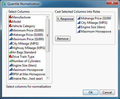

Open the data table containing all of the data columns to be compared, then select Add-Ins > Quantile Normalizer. This example uses the Cars 1993 data table from the Sample Data folder. Select the columns to be transformed and the click Y, Response.
Click OK.

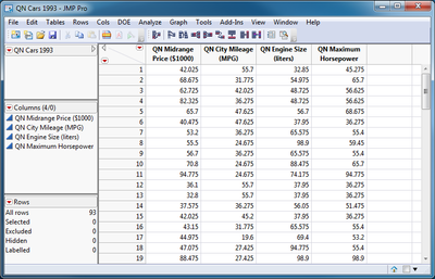

The transformed variables are added to a new data table.
