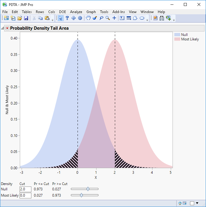

Several example tables are attached, and the one named pdta_normal.jmp produces the following output. It illustrates the equivalence of a one-sided p-value and Bayesian posterior probability of having the wrong sign under normal inference on a mean.
You can change the cutoff values dynamically in three different ways:  1. Click and drag the vertical dotted reference lines. 2. Enter values in the Cut boxes. 3. Click and drag the diamonds in the slider bars.
