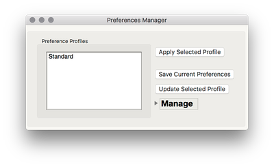

When you first install and launch the Preference Manager from the Add-Ins menu, you will not have any saved profiles. Start by saving your current JMP preferences by clicking "Save Current Preferences." You will be prompted the enter a name (in the example below I use "Standard").
Pref1.pngYou have now saved the current preferences to the "Standard" profile.

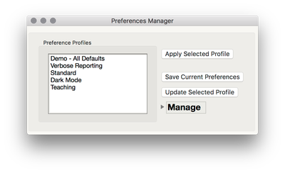

Often it's useful to maintain more than one profile. For instance, if you sometimes run JMP in front of a classroom and want particular settings for that situation, preferences that are different from your day-to-day analysis settings. Or, perhaps when running certain kinds of analyses you prefer verbose output, but want to switch back to your normal preferences after finishing that work. This is where storing multiple profiles is useful.
To save a new profile, make the desired changes to your JMP preferences (File > Preferences or JMP > Preferences on a mac), then open the Preferences Manager, and select "Save Current Preferences." Give a new name for this profile, and click OK. You will now have another profile and can switch between profiles when you wish to envoke those new settings. To enable a profile, simply select the profile in the Preferences Manager, and click "Apply Selected Profile."

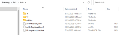

Separately, if you find you are missing your profiles when moving from 16 to 17, that is likely due to the change between those versions in where Add-Ins are stored in Windows (the folder SAS in the path is now JMP), so you'll need to copy those existing profiles over to the new location once the Add-In is installed in 17+.
In Windows, in 16 and earlier the location is:
C:\Users\[username]\AppData\Roaming\JMP\JMP\Addins\JMP.Preferences.Manager\usrPref
In 17+, the location is
C:\Users\[username]\AppData\Roaming\SAS\JMP\Addins\JMP.Preferences.Manager\usrPref

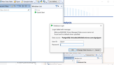

I just install JMP 18 from 16 and when i tried to pull wanted to open a file it become like this and need to enter a password.
can anyone help me. Thanks
