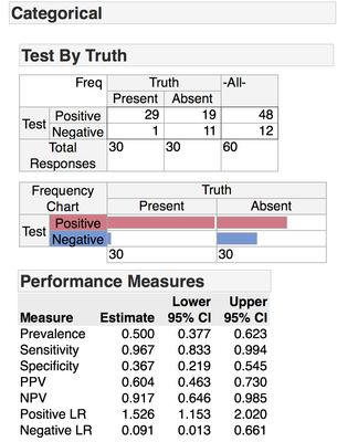

The IVD Performance Add-In was designed for quick reporting of diagnostic test results.  The output includes the common  2x2 table of results, a frequency chart, as well as the standard performance measures of a diagnostic test and their associated 95% score confidence intervals.  The Add-In also supports a "by" variable. The measures include:
  • Prevalence
  • Sensitivity
  • Specificity
  • PPV (positive predictive value)
  • NPV (negative predictive value)
  • Positive likelihood ratio
  • Negative likelihood ratio
For likelihood ratio confidence intervals are based on the method in Simel, et. al.
Likelihood ratios with confidence: sample size estimation for diagnostic test studies
J Clin Epidemiol. 1991;44(8):763-70.
Simel DL, Samsa GP, Matchar DB.

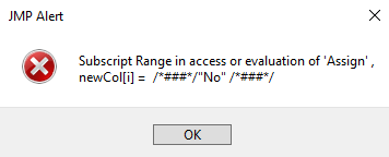

This seems to be a great add on! , but it happens to keep crashing in JMP 16 , does it require some specific data format to work or is it version-specific for JMP 14 only?
Thanks!!
Raul
RiztCL
This is the actual error that I get,   please your advise , thanks!
