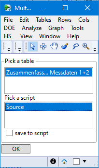

  1. Open and configure the first file you want to import.
  2. Start the AddIn.
  3. Select the table.
  4. Select the "Source" table script.
  5. Click OK
It will add a new table script or you can save it as a JSL file.

Hi @SamGardner
When you open a text file like this sample data set iris.data.txt, you automatically get a Source script with a fixes string of the location of the file.
If you want to import another file, you have to manually change the JSL code with edit to the new location.
The add-in now let you select this script and alter the JSL code with the following features:
  • replaces the fixed file string with the  Pick File( ... ) option so you can select the file you want to import.
  • You can select multiple files and it goes trough a for loop and concatenate them for you.
It is similar to the Import Multiple File function in JMP. But this has limited Settings you can choose from especially with PDF, excel and so on.
