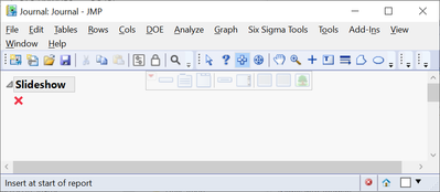

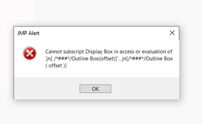

I have trouble inserting my slides. I exported the slides from Powerpoint in jpg in a folder and point to this folder. the first slide appear but I cannot go to the next one. This error message appear
Does any one knowing what cause this error?

Hello @brady_brady ,
For some time now I've been having a problem trying to import slides into a journal. The slides are saved separately as png, I've followed the correct steps (I'm used to doing this and I've reviewed the video just in case). I also saved the folder directly in C:.
with the following error message :
" Cannot subscript Display Box in access or evaluation of 'sb[ /*###*/pictbox(2)]' , sb[/*###*/pictbox( 2 )] at line 81 in C:\Users\fraemr\AppData\Roaming\SAS\JMP\Addins\com.jmp.brady.JournalTextSledgehammer\SlidesIntoJournal.jsl "
I'm using 17.1.0 (wanted to try on v16 but I don't have access anymore).
Emmanuel
@mgerusdurand and @Emmanuel_Romeu , the error you are seeing is most likely a result of trying to advance a slide with the journal locked. Please unlock the journal and see whether this error persists.

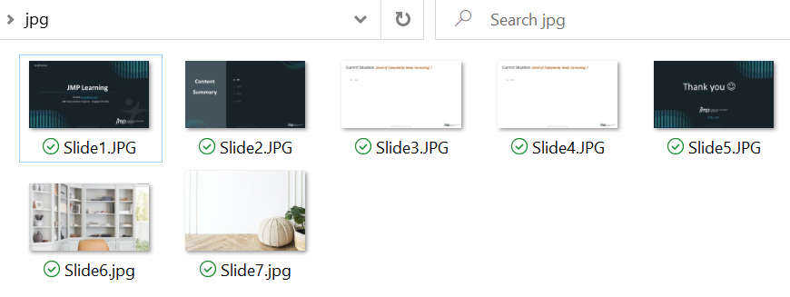

fredwcf
I also encountered the same problem and found the problem by accident.
1. SlideX numbering must start from Slide1;
2. Although the default image format is .png, you still need to select it.
Finally solved it.
