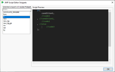

Usage:
Write #snippet <optional search term> (optionally user can use #sni or #snip instead of writing the whole #snippet) into your script editor. #snippet is used as a lookup value and if you include optional search terms, those will be used to pre-fill the search bar. After you have #snippet in your code, press Ctrl+Shift+Space to launch JMP Script Editor Snippet window, search for correct snippet and press OK (you can sometimes also just press Enter / use Tab to get to Enter). #snippet line will be replaced with the snippet you selected. Below is image of the snippet window
Snippet window
If user runs the add-in and there is no #snippet found from the script box, nothing will happen. If you don't want to insert snippet, press Esc. If you by accident insert snippet, you can try to press Ctrl+Z to undo the change.
User can access this community page for help and open snippet folder from the add-in menu

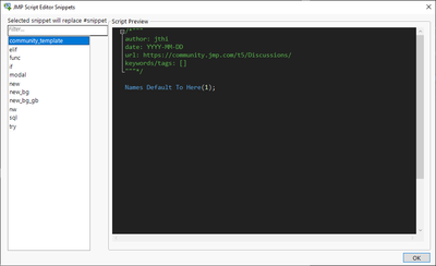

Pre-installed snippets
Names of these snippets are kept short on purpose, so user can easily write the whole name as <optional search term> after #snippet. Using snippets this way allows user to immediately pressing enter to use the wanted snippet.

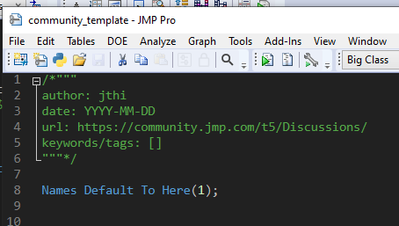

In this simple example I will create new script. The script will have one function which will perform an SQL query and then return the result table.
First I will start a new .jsl script file. I will start by writing
#snippet new
next I will run the add-in to replace that snippet. Because I have pre-written the whole snippet name to the #snippet line it will be pre-selected for me
and I can just press enter immediately after opening the add-in to use that snippet.
